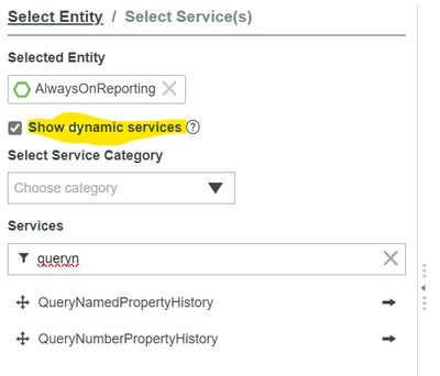

In Select Entity you can select your Thing Name
Select Service QueryNamedPropertyHistory service in service category

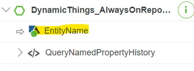

After that, pass your thing name to EntityName

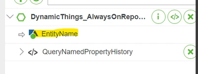

Hi @Pratik_Aswale
Pass Thing Name from Drop down to service dynamically. It should work.
Pass thing name from drop down
