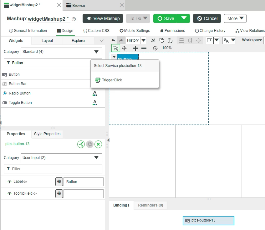

I am learning the Button, when it come to step 2, Click and drag the clicked service shown in the drop-down onto a free area of the Mashup canvas, i can't get the ResetInputsToDefaultValues service.

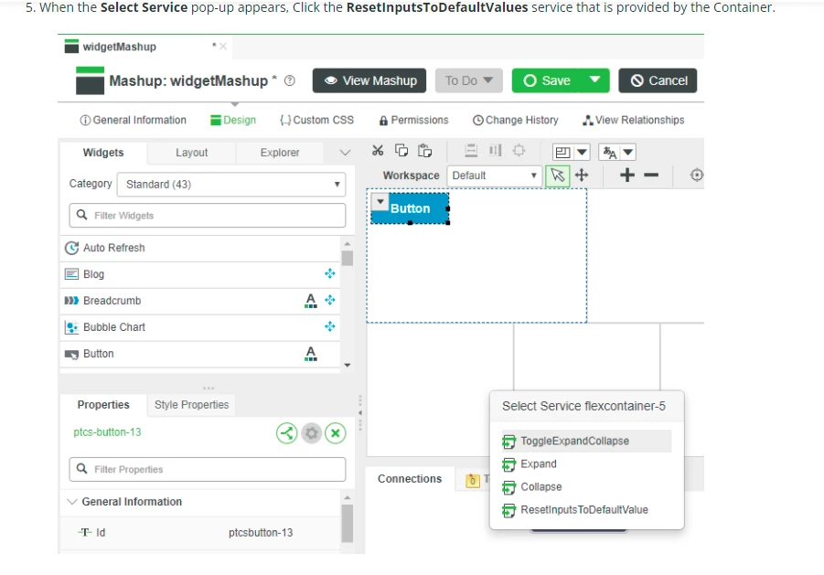

the guide displays this:
however i get this:

Drop the button "Clicked" event on empty space of container not on button.
