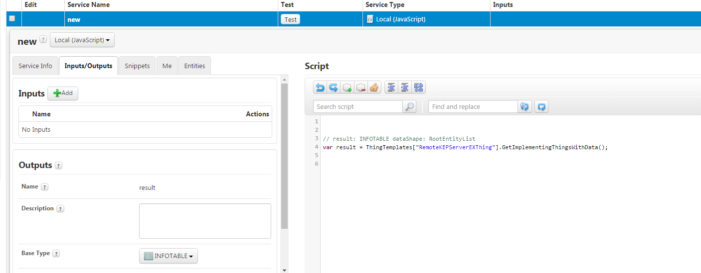

I have question on GetImplementThingsWithData Service. Actually I would like to know how to fetch all data from GetImplementThingsWithData  into my own service and apply filters on those date so that I can create a infotable of filtered data. Please give me solution for the same

Not sure I fully understand the question. You want to use getImplementedThingsWithData in your own service, then modify/filter the result of it, and output an infotable? To do it through a service, you may use  the GetImplementedThingsWithData service which results into an infotable:
You may further add the filters needed with the snippets or your own code to produce a new/filtered infotable.
You may also use a mashup, bind all data from the GetImplementedThingsWithData service to a, say, Grid, and then bind it to a data filter widget.
