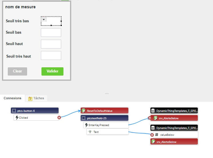

- I made a service that update alert threshold for all things of a template.
- I want to modify threshold from mashup (see picture) using textfield widget and call the first service when I click on a button (validate).
please help , and thank you in advance.

First of all, thank you for your response.
I created 3 services that us AddOrUpdateAlerts() : below _ above _in range. i think I should put all those services on  a subscription if i want to use the button to trigger those services ?
also i have a problem with thresholds precisely at the point of calling service for in range   :
for example : alert1 : measure <10 ===> call service for below alert
                      alert2: 10<=measure <20 ===> call service for in range alert
                      alert3: 80<=measure <100 ===> call service for in range alert
                     alert4: measure >100 ===> call service for above alert
so how can i call a service two time from mashup.

To execute a service more than once in mashup, you need to change the bindings, so one idea is to get once again the service in the Data panel and create once again the bindings.
I would work with one service for every alert, but I don't know exactly what you need to do or if this fits to your case.
