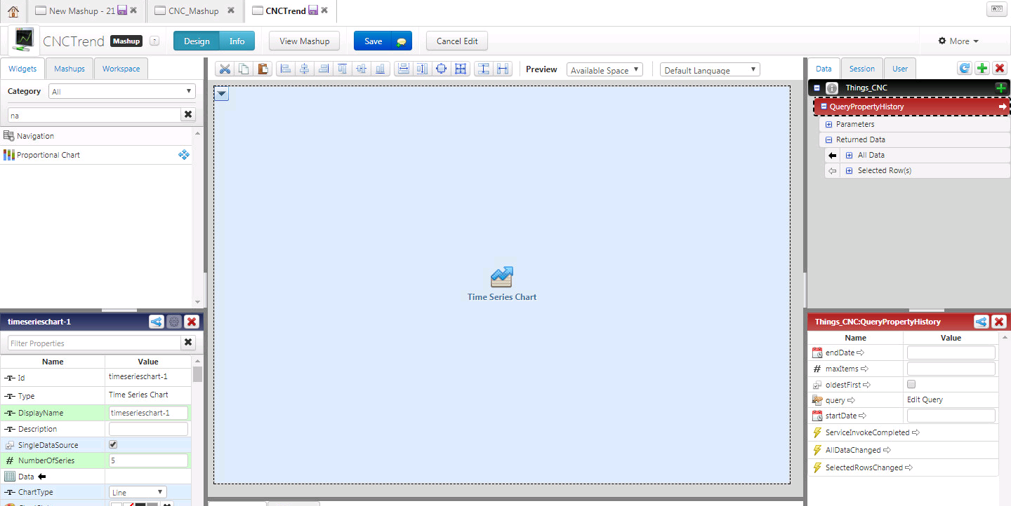

I have 4 mashups and all of them call, by clicking a button, another mashup that displays a trend. Instead of creating one trend mashup for every mashup, I would like to have one trend mashup at which you can pass the data every time you call it.

Hi Polina,
Many thanks for the information. I did steps 1 to 3 and my mashup2 has got a trend widget and a QueryPropertyHistory, what is the parameter in this context?
In step 6, where is the Navigation property? If I try to bind All Data from the service to the navigation widget, it says that it is not compatible.
Thanks.
20-Turquoise
September 28, 2017
You have to select the mashup in your Workspace tab (so it's in focus), then click on it and Add Parameter, include the type. When you bind that mashup to the navigation widget, you will be able to bind data (one value per parameter type). Meaning, you can't do ALL data, but rather each value individually. I'm not sure if there is an infotable parameter.
