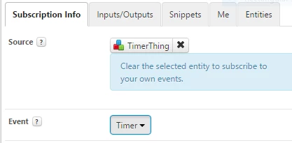

i want my service should automatically execute after every one second.

Hi Priyanshi Saxena​,
You can use Timer event for that. But as per my understanding 1 sec would be too early. Can you explain your use case.
You can subscribe to the timer event and call your service in the subscription code.

September 21, 2016
For different time intervals you need to create different timer things with different configurations and then Add subscription in Things, Thing Templates or Thing Shapes wherever you want. In subscription info tab select Timer thing(Timer thing configured with desired time interval) as source and event as Timer
Thanks!
September 21, 2016
You have to go the the Timer thing you created on the composer and go the the Configuration options on Left panel.

September 21, 2016
TimerEvent it's triggered on TImer thing frequency, if you want to have different frequencies you need different Things.
