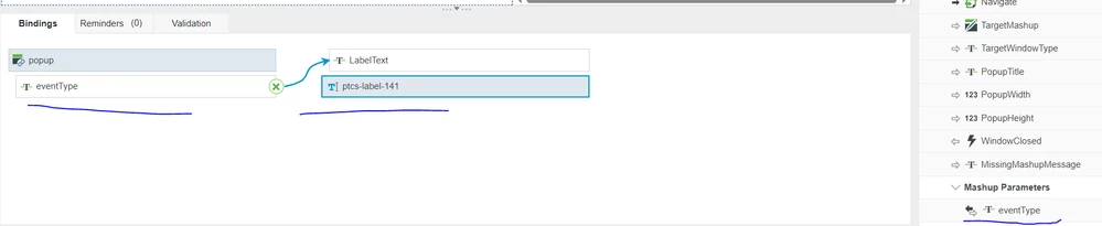

how can we redirect from popup mashup to main mashup after selection in popup mashup.
I have a main mashup which has some widgets. I added a button in main mashup which is for popup mashup. when I click on that button, a popup mashup is  getting populates. In popup mashup I have a dropdown widgets which I bind with the Things service like GetImplementingThings.
So now I want to know how  can we get back to main mashup from popup mashup after selection of thing from dropdown?
Thingworx version-9.3.9

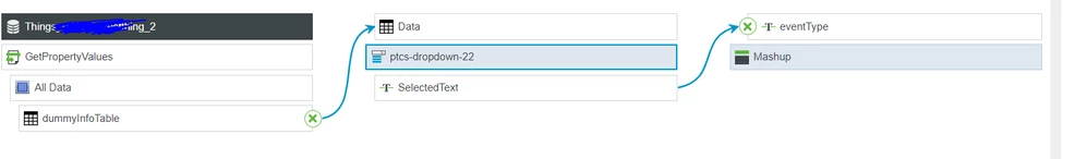

Hi @Pratik_Aswale
In Popup Mashup, create a mashup parameter to pass data from Popup to Main mashup. And bind dropdown selected text value to mashup parameter
In Main Mashup, map the popup mashup parameter to change the gauge value. In my case, I have mapped it to the Label

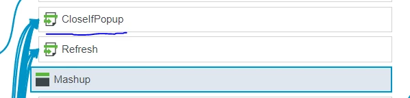

Hi @Pratik_Aswale
You can use "CloseIfPopup" trigger to close the popup when dropdown selection changed

@Velkumar In my scenario-
I have a gauge widget in main mashup and a popup mashup button. after clicking on button, popup mashup getting generated. In this popup mashup having a dropdown widget which have a things data.
Now I want to change gauge widget data which is in main mashup after selection of  thing from dropdown and then want to redirect from popup to main mashup.

Hi @Pratik_Aswale
