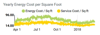

And another question about Line chart. How do I customize my Line chart  like this

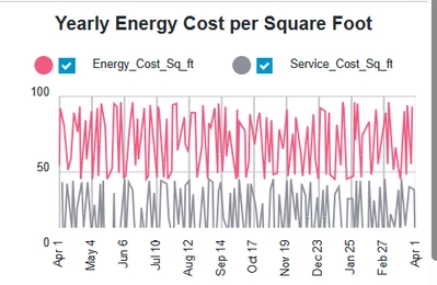

how to show X-axis and Y-axis value and auto scale like this I am try to do that but my result looks like this  螢幕擷取畫面 2024-01-11 105215.png
looks totally different, I want to know how to show Y-axis value only max and min, and show X-axis from Apr1 and the tick is 2 months and end at 2018 but the line still go through.

Third question. How to achieve this
that this Line chart have bold min value and bold max value and normal 50 value as Y-axis tick.  And like Line chart  first question The X-axis tick is start from Apr1 and end at 2018 but the line didn't stop still go through.

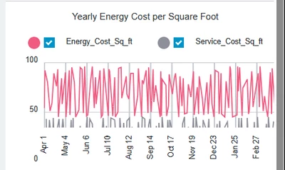

I try to do this but the result is looks like
the line ends at Jan 16.

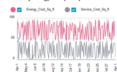

And for chart question I am my Thingworx version is 9.4.1, but I tried all the configuration I still can't do auto scaling.
Like this picture.
My gray line is cut only show the top of it, and the whole line chart should looks like this
According to your reply is it not possible to look like the demo because of the new version Line chart widget?
Thanks again for your help!

The new version of the Widget is based off a different library (lit) than the older version (polymer). It is a re-write and some features are new, some are not and some are not supported (yet). So the configuration and behavior is different from the older widget. That's why I said you will probably not get the identical presentation with the new widget. It's a trial and error process (at least for me).
