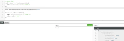

you can get current configuration via
// result: JSON
result = Users["Test"].GetPersistentValue({
	name: "profileConfiguration" /* STRING */
and set it back via SetPersistentValue

I tried to run the service on several users, but it always returns empty.
That indicates that the service does exist but does not return any valid JSON result. Maybe there was a change with ThingWorx 10.0.0.
I checked in PostgreSQL and didn't find any kind of profile configuration in the user tables.
I'll continue to check where this will be stored - because, in the end, I think users should not have ALL rights and permissions by default. It needs to be an additive model instead of a subtractive one.
Aug 22, 2025 9:05 AM UTC
You are (somewhat) right, interesting.
If I did not save the profile configuration in composer for the user first, I do get empty result.
If I saved it once I do get the result.
It seems that it does not return the "default" settings. But for sure you could write the settings to it.
So the services work as desribed before but you need to handle the case where it was not yet changed. (also works in twx 10)
