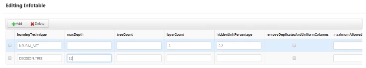

how do you get to this page on thingworx?
Hi, i was thingworx model tutorial. how do u get to this page on thingworx composer?Capture.PNG

it says
In ThingWorx Composer, search for <Analytics_Server>_TrainingThing
Under Services, select CreateJob , click Test.
But i cannot seem to find Analytics_Server_TrainingThing or even AnalyticsServer_TrainingThing.
