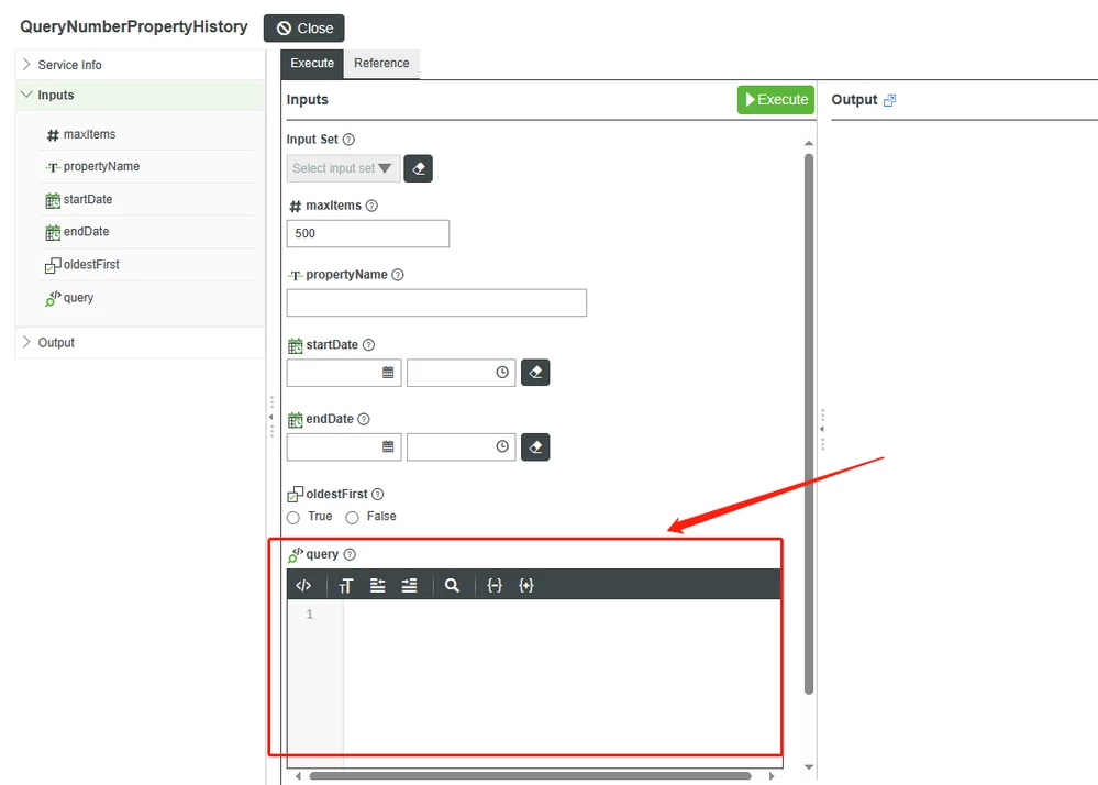

How does the "query" function work?
Hello,everyone!
How do I write a query the QueryNumberPropertyHistory service?
I want to query values greater than 10.
thank you!

Hi @Snoopy_hu ,
Kindly find the below snapshot of Query input of service - QueryNumberPropertyHistory.
Also find the attached link for Query Parameter for Query Services   & Using JSON Filters in Query Services.

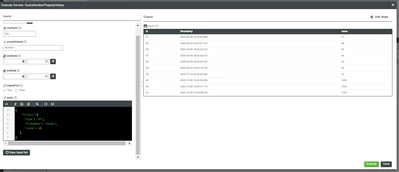

 "filters":{
 "type": "GT",
 "fieldName": "value",
 "value": 10

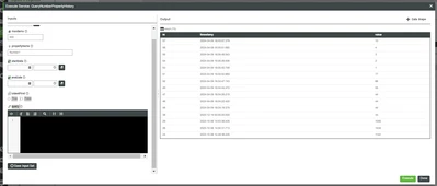

Complete Result:
Expected Result:

Hi @Snoopy_hu ,
 "filters":{
 "type": "GT",
 "value": 10

Expected Result:

Hi @Arun_C ,
Ok, I tried it successfully through your method, thank you very much!
