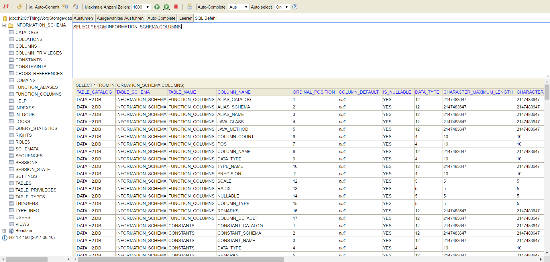

I just try to view some data out of my Thingworx instance through the H2 Console. Does anyone know in which table I can find something?

May 17, 2018 5:00 PM UTC
I finally found the solution:
Instead of connecting to the directory
jdbc:h2:E:\ThingworxStorage\database
you need to connect to the database name. The name of the db file is data.h2.db So you need to connect to
jdbc:h2:E:\ThingworxStorage\database\data
and you will see all the tables (your absolute path will differ):
Now you can query all the tables!
Nico
Dec 20, 2018 2:31 PM UTC
And leave the user and password blank
