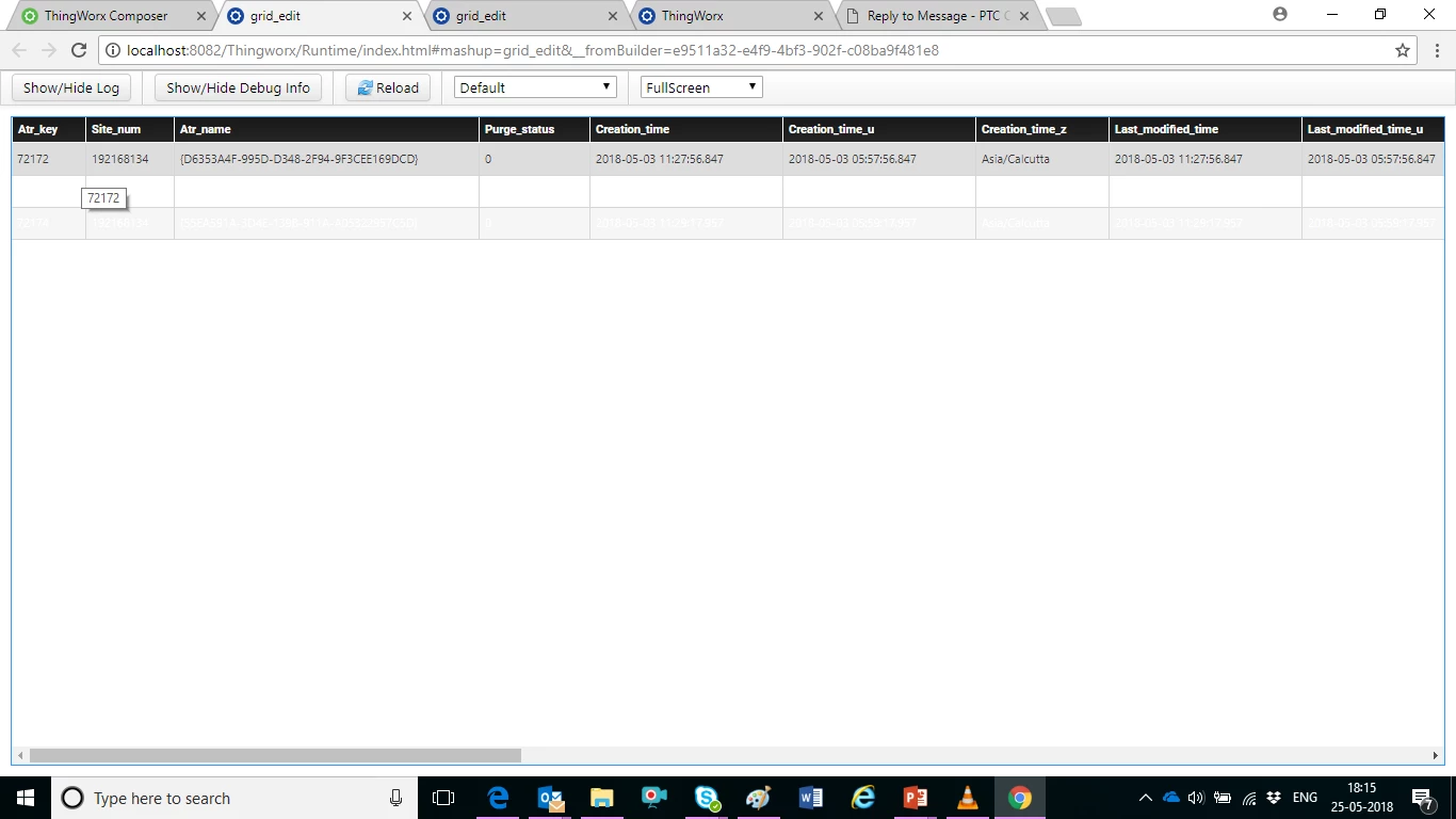

Hi ,
Thanks . But i already changed the settings in configure grid tab. but i dont see any change in the output of mashup .pls check the image attached, that is how my output is . i want to know how to add or delete columns in that .
