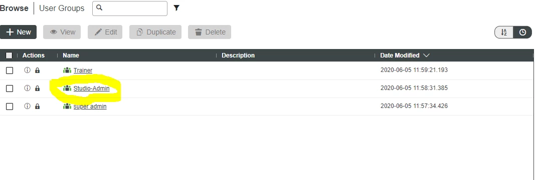

hello,
want to assign home mashup to user group.
