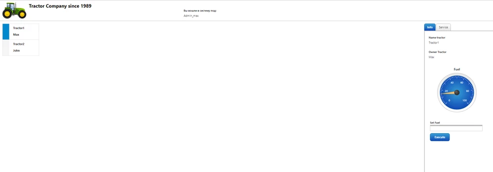

I have Tractor things (Tractor_General_Template => Wheat_Tractor_template or Rice_tractor_template).

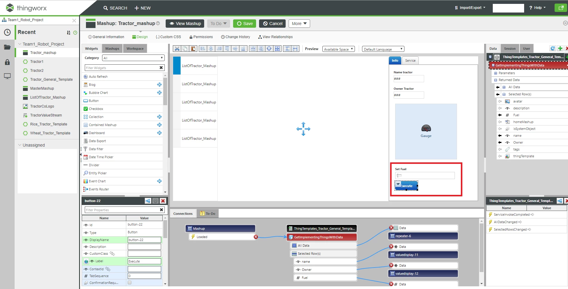

I have Mashup with GetImplementingThingsWithData from Tractor_General_Template.
I have question : How i can set fuel properties for selection tractor?

You'll have to use another service to set the properties (either use one of the existing services or write your own using the snippets). You'll then bind/feed the data to the service and execute it to update the properties.

February 13, 2019
Thank you! I created new thing for scripts "ScriptThing" and execute service from his. Its ok?
