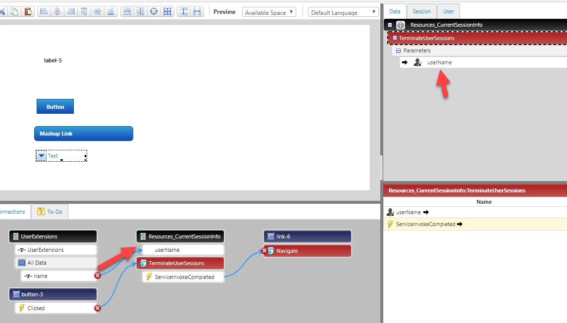

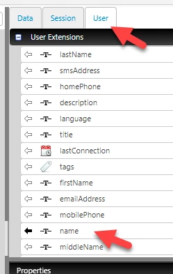

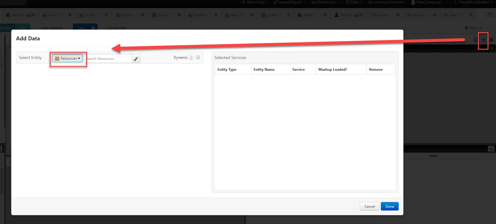

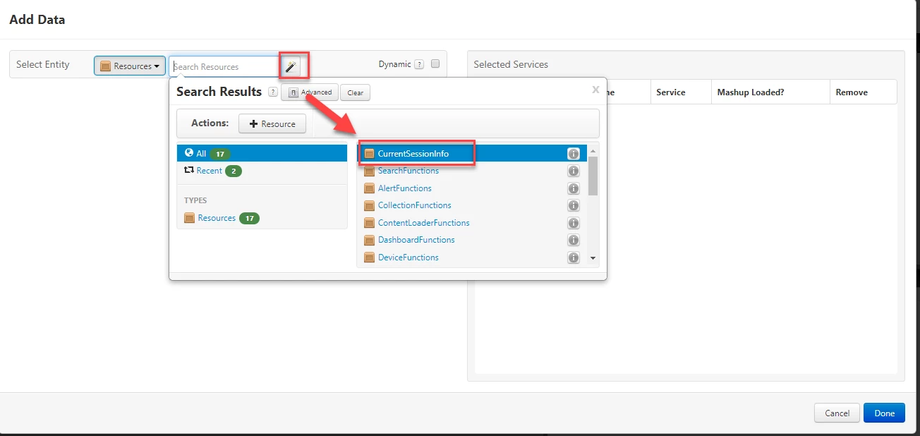

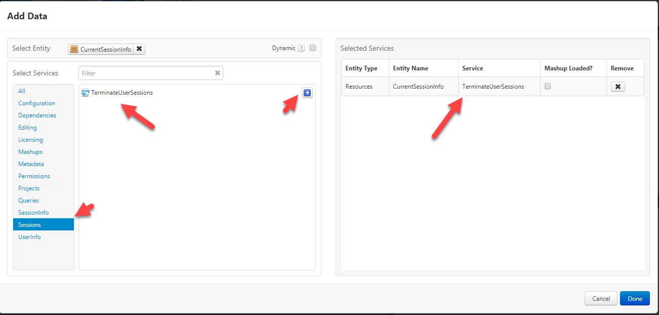

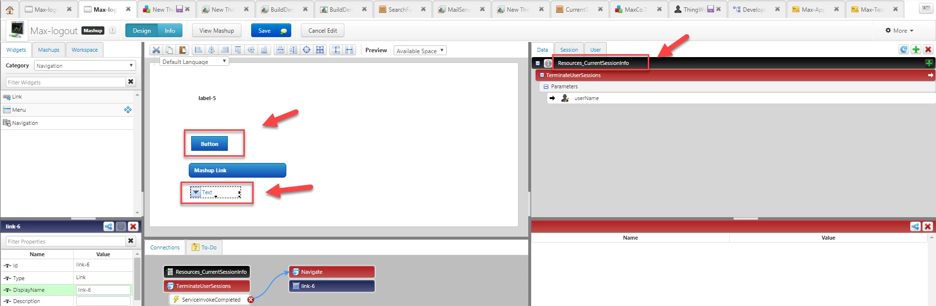

Hello @Ru_01
Just like my reply in another post, you can directly add the corresponding resources to your mashup.
Please refer following pics.
