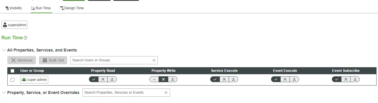

by using this "superadmin" user i want to create another user in thingworx but when i am creating a user the error appears that "not authorized for Create".
 and i gave visibility, design time and run time permissions to "superadmin" user as well as group.
some screenshots i have uploaded below please check once for your better understand....

Could you confirm if your user also has a design time "Create" permission?
