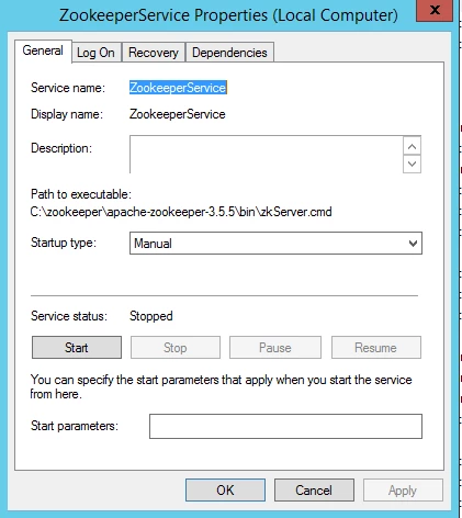

I was able to create the service using below command.
sc.exe create ZookeeperService binPath= “C:\zookeeper\apache-zookeeper-3.5.5\bin\zkServer.cmd

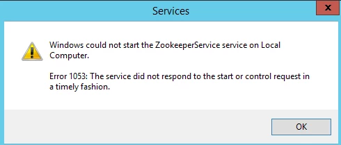

Service is created but it is not started and an the getting error. Please refer the attached screenshot
Could you please help on how to run background service.

Thank you for replay.
Alwaysup is not free software.
Is there any otherway i can run Zookeeper as background service.Service is created as Background but not able to run the service.
I am getting the error "Error 1053: The service did not respond to the start or control request in a timely fashion".
I have updated "ServicesPipeTimeout" and also did the ccleaner. Still getting error.
Could you help me on how to resolve.
raluca_edu
You can also try with NSSM: https://nssm.cc/download As far as I know, this one is free.
Can you check Events log and search for the error you have to get more messages related to the error?
