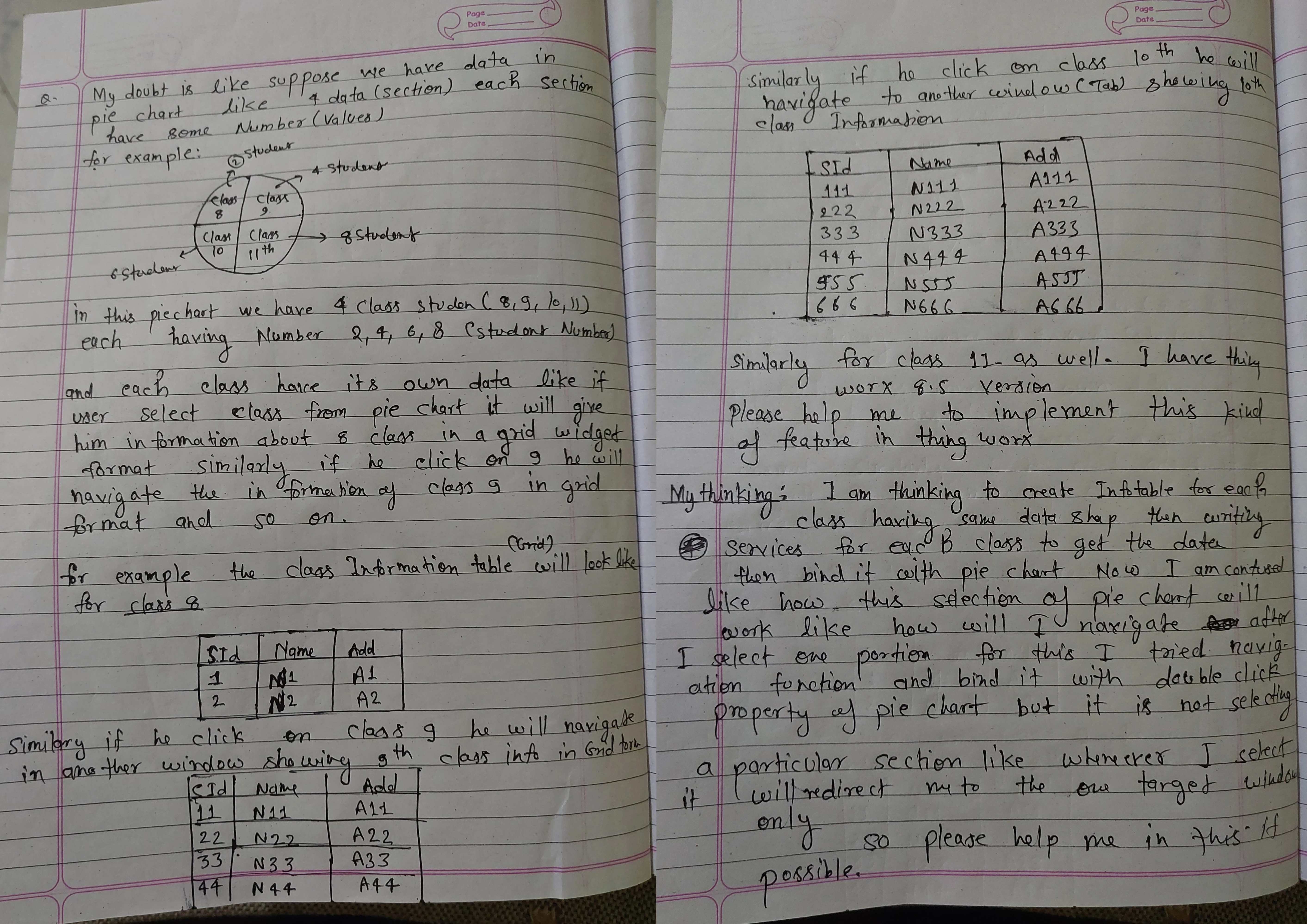

How selected section of pie chart widget will work in thingworx 8.5 version
Hi all,
My question is like how can I configure pie chart widget in Thingworx 8.5 so that when I click on a selected part(section) it will navigate to another tab related to the section similarly If I click on different section of Pie chart it will navigate to different tab (means data associated with that section)
for better understanding I have attached image
please help me to configure this
and if possible please share the image of how you bind it and.

Hi @Rayon_11
You can use the Expression function and Navigation function to achieve this.
When the Pie Chart is selected, pass the selected value from service to Expression. In the Expression function based on input return the Mashup name.
Map expression function output to Navigation Function Parameter 'TargetMashup'.
Note: Set AutoEvaluate enable in Expression Function and Trigger Navigation Function when the Expression Function output value changed

Hi sir,
If you do have sometime please do atleast the service part beacuse I have no idea how to write service
Rayon
Nov 24, 2023 8:55 AM UTC
Hi @Rayon_11
Could you please provide sample data that you have in Thingworx
/VR
