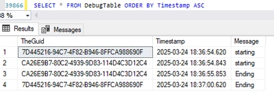

- At the beginning & end of your SQL code, and ideally at some points in the middle as well, add records in a debug table with the current time & a common variable. Here's an example :
DECLARE @guid UNIQUEIDENTIFIER
SET @guid = NEWID() -- This saves a random guid into the variable and will keep it for the rest of this execution
INSERT INTO DebugTable(TheGuid, Timestamp, Message) VALUES (@guid, GETDATE(), 'starting')
-- execute your procedure here
INSERT INTO DebugTable(TheGuid, Timestamp, Message) VALUES (@guid, GETDATE(), 'Ending')
The results will look like this :
In this example, the 1st execution (the one starting with "7D4") took 6 seconds, and the 2nd execution (the one starting with "CA2") took 1.01 second. Using this you can find if the issue is within the SQL part of the system or outside of it. And also if you have more messages in the middle of your code then you can find if specific sections take more time. You could also add the stored procedure parameters in columns of your debug table, you could find if specific parameters (like a specific machine ID/name) take longer.
