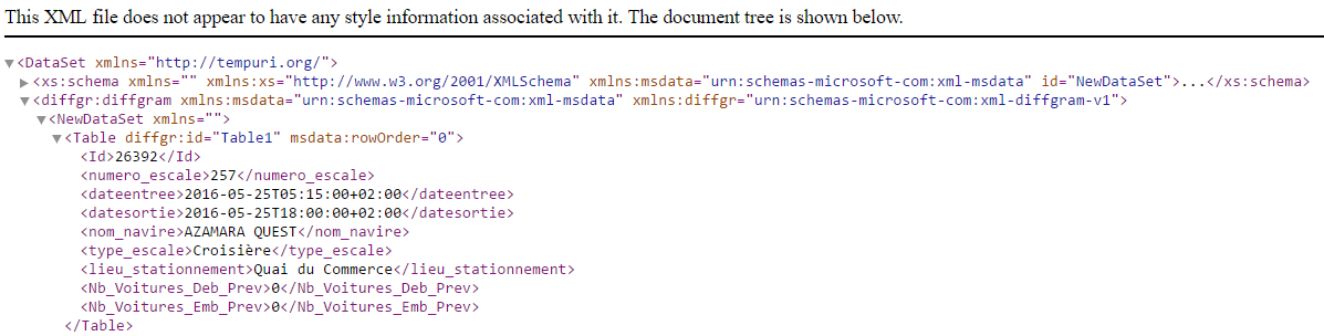

June 9, 2017
Hi Pai Please how can i access the elements (Id, numero-escale ....)

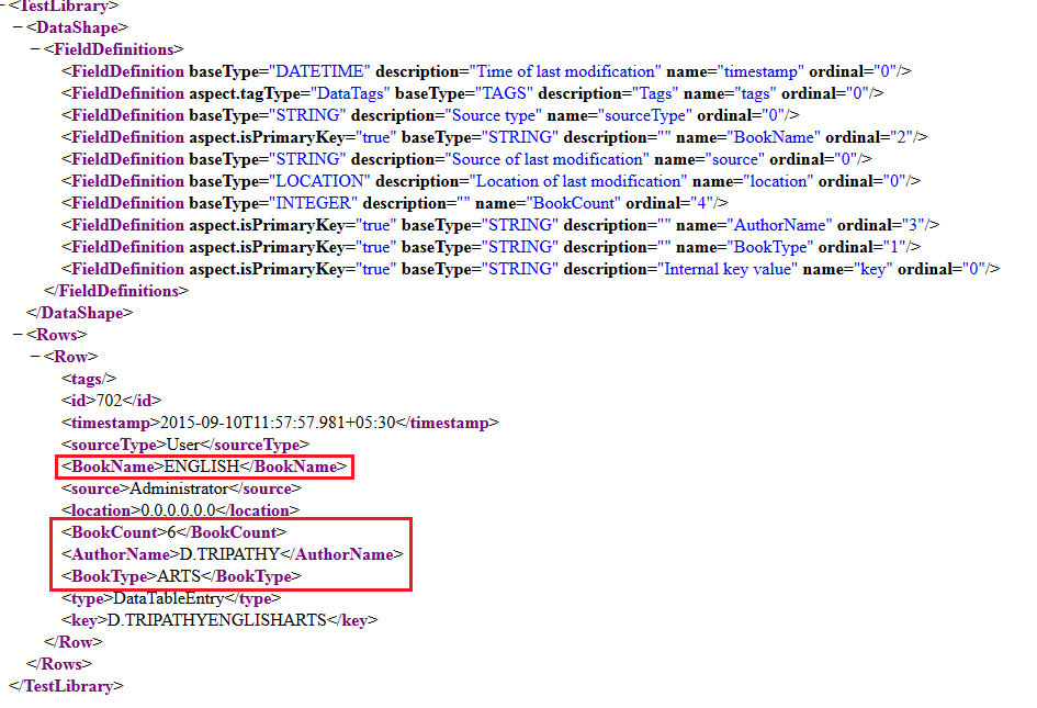

September 14, 2015
Hi Joshua/Pai,
I need one help. I have an URL. Whenever you will hit the URL ,it will generate dynamic XML based upon the User Selection. But problem is , the XML i am getting or getting generated by ThingWorx contains some unwanted filed provided by Thingworx. How can i am write the query so that i can get the correct format of XML. Below i have given one snapshot of generated XML where i need the highlighted tags as an output from the URL. I want to know what kind of service shall i write so that i will get my required output in URL in XML format. I just wanted the highlighted XML tags only.
Thanks & Regards:
kshirod
