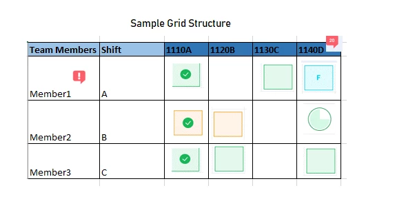

How to achieve dynamic grid column with shapes and shapes formatting
Problem Statement
Built in grid feature in Thingworx is not supporting shapes, we are facing challenges for design front and dynamic column construction with shapes, and shape formatting with grid structure
1)Required Grid with dynamic column.
2)Within the grid required to display shapes, images and
need to do state based formatting for shapes
3)Need tooltip for data and column header

@PEHOWE  Thanks for your suggestion. Please find our queries below.
1. In Attachment (GridRequirement.png), column 3,4 ,5, 6 ... are dynamic, and we don't have control on number of column during design time. With this scenario how to achieve dynamic set of columns.
2. From advance grid how to get particular selected cell details.
Hello @priya_A,
With the requirement to have dynamic column configuration, you will need to dynamically create a Data Shape to describe the columns. This Data Shape will be used to create the InfoTable. Rows will be added to the InfoTable.
Please review the following articles:
The result will be something like:
    var dataShapeNameParm = "TestDataShape";
    // Replace <nameOfDataShape> with the name of the data shape to delete. (Note: Case sensitive)
    var params = {
        DATASHAPENAME: dataShapeNameParm /* DATASHAPENAME */
    // Replace <ThingName> with the name of the Thing that the service has been configured on.
    Things[<ThingName>].DeleteDataShape(params);
    CreateDataShape (NumberColumnsSelection, dataShapeNameParm);
    result = Resources["InfoTableFunctions"].CreateInfoTableFromDataShape({
                infoTableName: "InfoTable",
                dataShapeName: dataShapeNameParm
    let columnData = CreateData (NumberColumnsSelection);
    result.AddRow(columnData);
Now this example uses 2 functions:
function CreateDataShape (numberColumns, dataShapeName) {
    /***** CREATE DATASHAPE ****/
    var params = {
    name: dataShapeName /* STRING */,
    description: undefined /* STRING */,
    fields: undefined /* INFOTABLE */,
    tags: undefined /* TAGS */
    //no return
    Resources["EntityServices"].CreateDataShape(params);
    for (let i = 0 ; i< numberColumns;i++ ) {
        let fieldName = "TestField_" + i;
        /******* ADD FIELD DEFINITION TO DATASHAPE *****/
        // Note: Datashape should contain one PrimaryKey for DataTable
        var params_AddField = {
        name: fieldName /* STRING */,
        type: "STRING" /* BASETYPENAME */,
        ordinal: undefined /* INTEGER */,
        primaryKey: true /* BOOLEAN */,
        dataShape: undefined /* DATASHAPENAME */
        // no return
        DataShapes[dataShapeName].AddFieldDefinition(params_AddField);
function CreateData (numberColumns) {
    let valueListObject = {};
    for (let i=0; i< numberColumns;i++) {
        var nameStr = "TestField_" + i.toString();
        var nameValue = i;
        valueListObject[nameStr] = i;
    return valueListObject;
You might be asking why as the first step do I call a service to delete the DataShape. I am removing the previous version, this allows me to create a new data Shape. The routine for the delete is described in the articles.
Please let me know if you have any questions.
