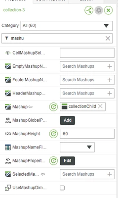

6. In parent Mashup, pass data to the collection widget from your service

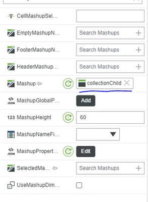

7. Set Mashup property value as your childMashup which you created in step 2
8. Set UID Field which should be unique for each row. In my example I have set rowNumber as UIDField which is unique for each row
9. Configure Mashup Parameter JSON to pass data from service to childMashup
In Mashup Parameter JSON, the key should be dataFieldName from Service and the value should be Child Mashup Parameter name
10. Set Mashup height to 60px (each row height) and View Type to Table in the Collection Widget property

Hi @S_Elsayed
Check here for the collection widget property definitions - Collection Widget (ptc.com)
To make the collection widget look like a Table / Grid.
In Collection Property, set View as 'Table'
Set your mashup height as per requirement.
