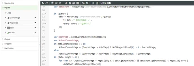

Aug 11, 2023 6:18 AM UTC
Hi @Willie ,
If I'm understanding you statement clearly, You need to query based on the main data and split it into pages?
Please take a look on the code snapshot it may hepls you. We added the "Query" snippet at top of the GetPaginatedEntires services with Input - "query" and then we formed the splitted pages row data based on the quired from main infotable - "data" & the serive were executed by 1 more event of "FilterChanged".
If Its not making sense means, Can you please ellaborate your query more for better understanding?
Thanks & Regards,
Arun C

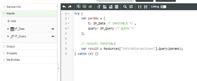

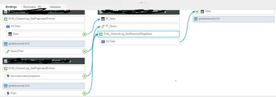

HI @Willie ,
We tried with below given steps were worked for us-
If need query/filter the entires on each pages, after all paginated data are printed on pages means, we created 1 more service with 2 Inputs,
  1. Infotable input - to recive the data from the service GetPaginatedEntries - 'Data' Field
  2. Query input - to collect the query fron grid widget
and Output as Infotable as same as in below snapshot to print the data to the GridAdvanced widget.
And bind the service exection events from GetPaginatedEntries - Invoke & Grid Filter Changed.
Thanks & Regards,
Arun C
Hi @Willie ,
Thanks & Regards,
Arun C
