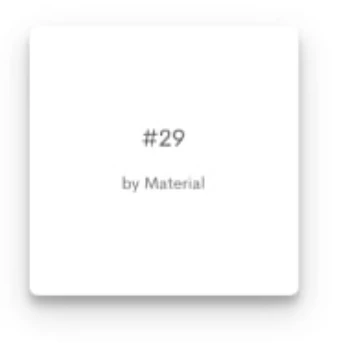

I have a value display in a mashup:
Where I want it to have a shadow effect on runtime, to be similar to something that looks like this:
How can I do that?

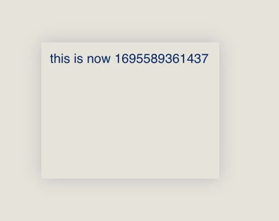

September 24, 2023
In the mashups custom CSS tab enter
ptcs-value-display:not([aria-disabled=true]){
 box-shadow: #bbbbbb 0px 0px 16px;
This will render a CSS box-shadow on the value display. Modify as needed...
