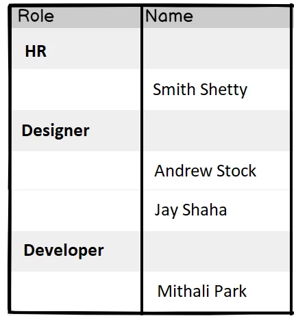

I want add data in the below format  please check attachment. I have a other page from where I can add Role and their member name So When I will add member in each department it should be add in their respective department. Can you please suggest which widget or any other solution to achieve this requirements.

I have already refer this article but I didn't understand what exact to do with tree advance widget. Can you please suggest I just want show and add my data in format please check above attachment

hi @slangley
