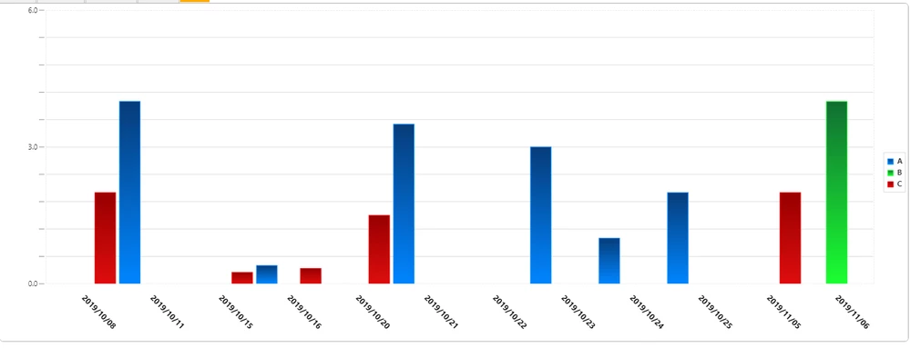

hi,
I have requirement to add the data series dynamically based my sql query. For example, i have data for shifts as A,B,C......n , and I want to display a bar graph for this NumberOfSeries. See the below screenshot, In this I have NumberOfSeries=3 which is fixed (A,B,C shifts data is displayed). But my shifts are not fixed ,they may A,B,C....n . So depending on the input series must vary.
Is there any way of doing this?
sheetal
zyuan1Answer
November 14, 2019
The Chart widget itself cannot bind dynamically to different number of threads, but if you can use a Contained Mashup widget, and create sub-mashup for 2-thread, 3-thread and 4-thread Charts, it could work.
