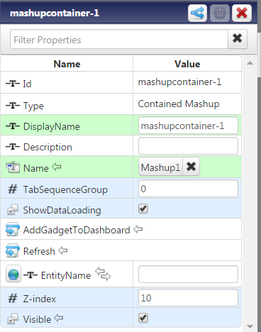

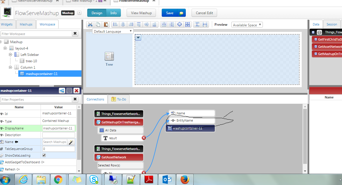

How to add EntityName in contained Mashup?
As shown in pic, when we add contained mashup name parameter usually available, but how to add EntityName?

    EntityName seems Mashup parameter of the selected mashup.
    To add it we just need to go the Mashup which is selected in the name property of the Container widget.
    In Workspace; click mashup and then click on Configure (Tool icon) to the Mashup Parameter.
    Now the Container widget will show this as a widget property after selecting the Mashup name.
    I hope it helps.
