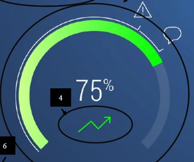

I have a requirement which is asking to add an info:
next to a progress gauge:
the mashup contains legacy widget:
How do you suggest i proceed? How to design it?
please note that the icons are svg tags.
Thanks.

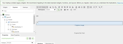

@PGOPAUL
Is this "progress gauge" a standard widget or legacy widget? Can you please show the node in Explorer tab of Mashup design page?
About legacy widgets, because legacy widget will be deprecated in future ThingWorx release, we suggest to replace them with standard widget. You can backup your current mashup, relogin ThingWorx and open the mashup then you will see below popup window where you can migrate those legacy widgets to standard widgets. After the migration, please test standard widgets work as expected or not.
