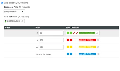

i need to design chart like below:-
i have tried this by using shape widget but i got the output in single color or single data. Now please suggest me how i design this chart with multiple colors or data. Or suggest me if there is any widget would use instead of shape widget. below m attaching the output of shape widget where i got only single color or data:-
22-Sapphire I

Have you tried to apply a state definition in the 'State Formatter'?
That should get you what you are looking for I think.

Yes i have tried to apply state defination in state formatter but still getting a single color:-
please share a solution as soon as possible

ahhh right ... it will only show the color of the value.
What I have seen people do is to do an overlay of several shapes for this.
Custom widget
Use a stacked bar chart
Maybe even the range chart can do it?
