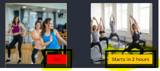

How to add running status of program through service??
         I want to show how many time is  remaining to start program for this How Do I add running status of program through service??please refer the below attachment
Thanks in advance
emscurAnswer
Sep 22, 2020 2:59 PM UTC
Hi @RM12,
You can achieve this by creating a subscription that triggers every minute from a Timer Thing and comparing the current date/time and programStartDateTime. Then, set property timeRemaining of the program to the difference between currentDate and programStartDateTime. This will set the property every minute and keep it up to date.
Emmanuel
