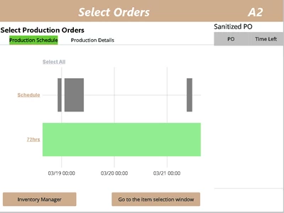

I use schedule widget to see data of 3 days.
as default, we can see all data.

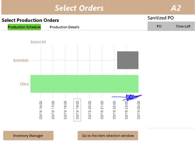

I know we can set start date and end date and once I set both date, I can see restricted amount of data though, I'm not sure on how to add scroll bar in X-Axis to see remaining data.
Could you let me know  we can put scroll bar in X-axis ?
Default  : display all data
Ideal : can see only data of a day.
scroll to see data of after the day
