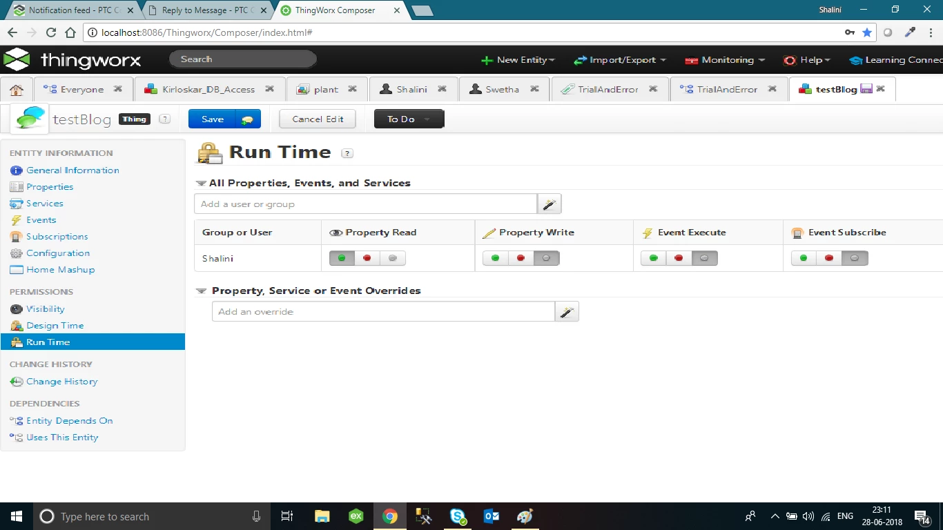

If you go to the Blog Entity in Composer and then look at Services you will see all the services associated with a blog.
They will need the ability to execute certain services like: GetBlogEntriesWithComments
You should use Override for this to specifically grant these permissions.
22-Sapphire I
June 28, 2018
As with any mashup it is all about the Permissions and Visibility settings.
1. Give the users the link to your blog page
2. Make sure that those Users are in a Group that has been giving the appropriate permissions to your Blog Thing Services
Note: Do NOT give the users FULL rights because that would allow them to delete/edit
Only give them the Get services and the Add Comment services etc.
June 28, 2018
Hi PaiChung,
Thanks a lot for your reply.
But still I am not so clear about it.
should I give permissions to users like this so that they can view the blog from their credentials?
In this run time, I should be giving only Property read right?
June 28, 2018
Hi PaiChung,
I just tried to give permissions like runtime and designtime after which,
When I logged in the User and tried to open the mashup which has the blog it shows me a status message like this:
"Not authorized for ServiceInvoke on RequestEdit in testBlog"
How should I give authority for ServiceInvoke on RequestEdit? Should I give it in the runtime?
Please give me some idea to make it work.
