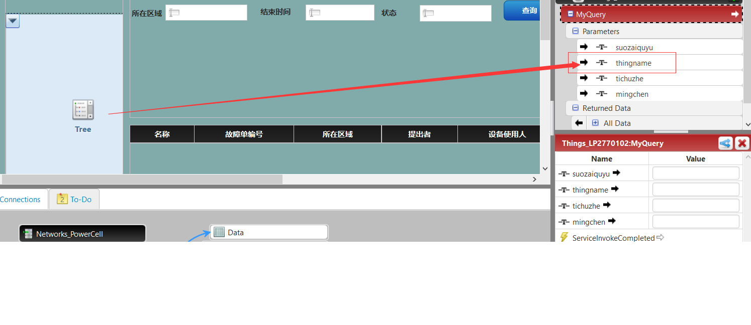

I want to click on the tree control, the selected value send to another control. How do I implement?

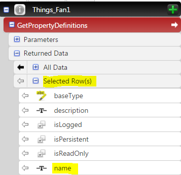

Hi Mr. Liang,
There must be a service that bounded with tree widget, and usually this service has a selected rows column. Please just bind the selected rows to aimed control.

Hi Ju Bin Liang​,
The Selected Data is generally returned from the Selected Row(s). We can select the Property too after opening the Selected Row(s).
Have you tried this already?

hi,Ankit Gupta
     I've tried
     It is feasible
     thank you very much!
