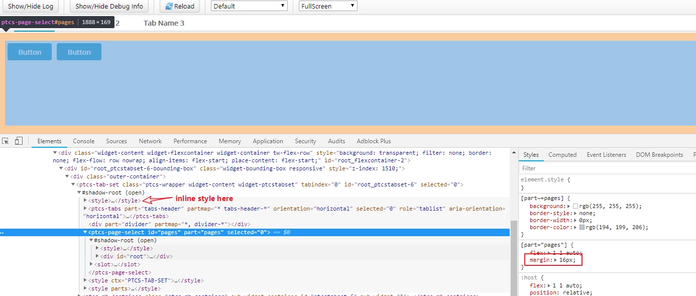

In Thingworx8.5, a style with attribute part='pages' is attached to Tabs' content. The margin value set in the style is too large. How can I change the margin value?

Try with custom CSS, like below:
ptcs-page-select::part(pages)
margin: 10px !important;
Hope it helps,
Raluca Edu
