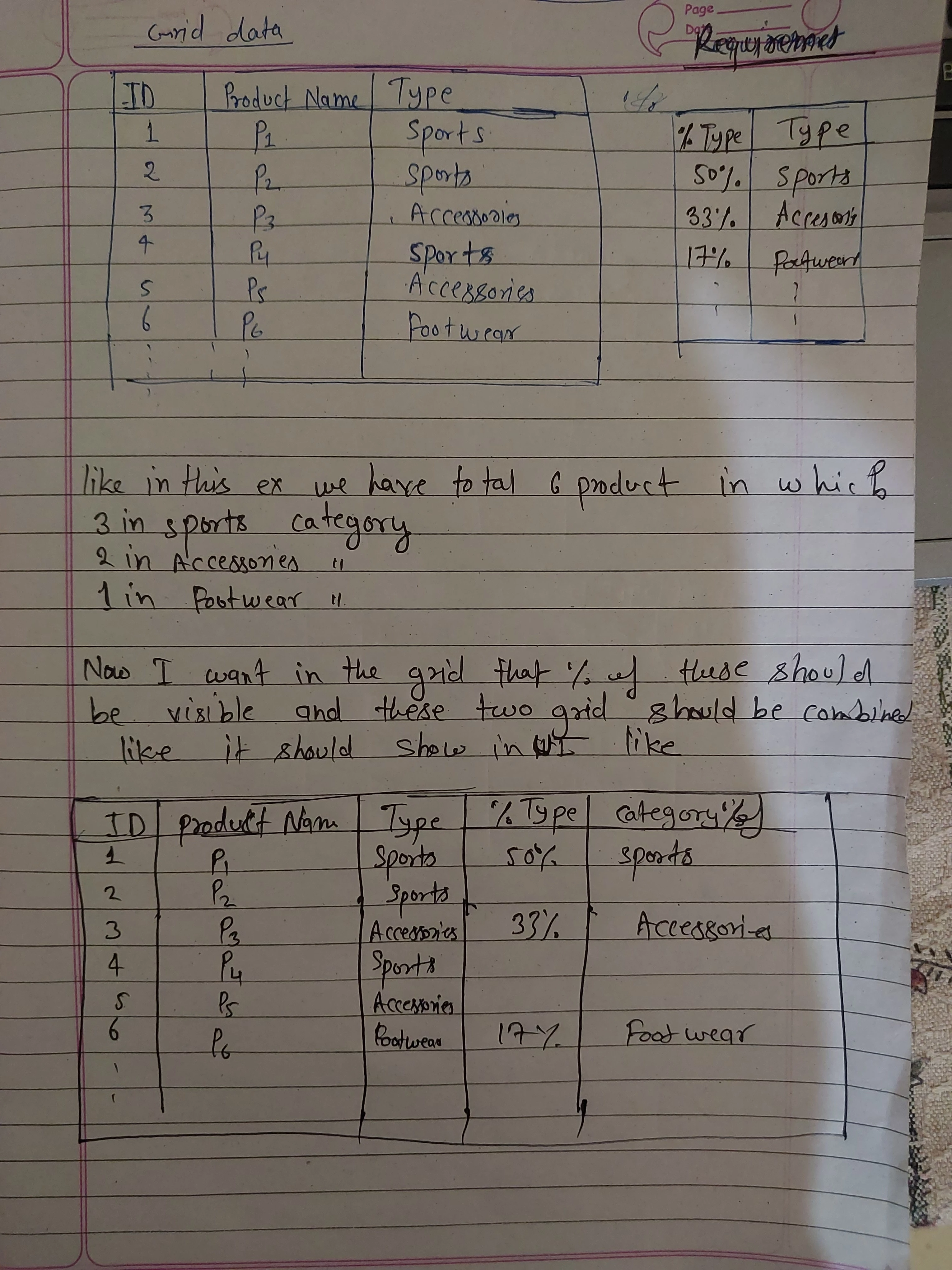

Hi all,
I have a doubt like suppose I  have some grid data for example suppose I have 3 column having column attribute like ID, Name and Type now I want to do some calculation on top of grid data like I want to show their number in percentage format.
For more detailed info I am attaching an image file
please help me
