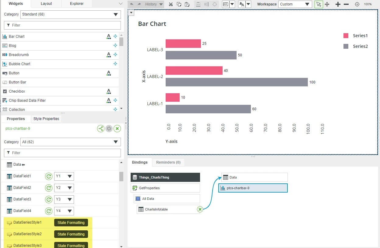

how to apply state formatting to label chart or any other chart??
         I want to apply below state formatting to label chart .Please suggest how do I apply state formatting??? and please refer below attachment

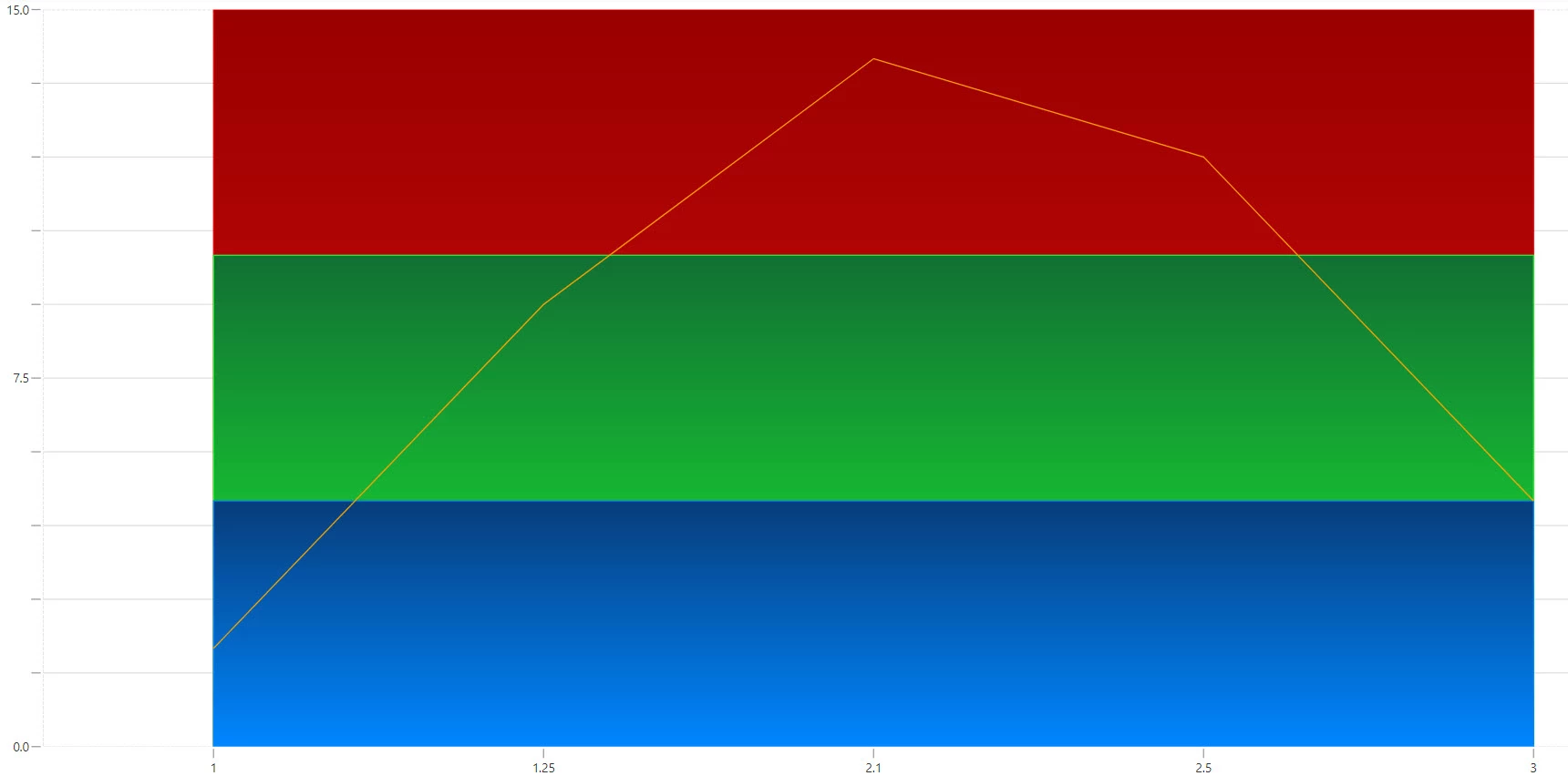

There is no out-of-the-box functionality in ThingWorx to display colored areas in the background depending on the value of the Y Axis. However, you can apply state-formatting to Label Charts using the Markers ChartType (or Line/Markers, Area/Markers) as shown in the attached screenshot Markers_StateFormatting.jpg.
You could possibly dedicate a certain number of series (= number of colors you want to display) displayed as Areas and then add a Line type series on top as shown in attached screenshot Areas+Line.jpg. This is not what the widget's multi-series functionality is originally intended for and this does involve the creation of Chart data especially for the formatting so I will let you decide if this is something worth implementing.

Hi @RM12,
Please find attached some entities that can be imported into ThingWorx 8.5 or later and that contain a Mashup with a Label Chart using State-Formatting. At runtime you will see that all values below 5 are displayed in green and all above 5 in red.

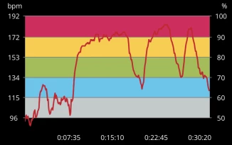

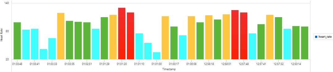

Mar 24, 2021 8:12 AM UTC
Thanks for your reply ,at runtime I will display my  data with multiple colors .I want to display legends as well in dashboard, I have one property name as "Heart Rate"  according to heart rate show legends as below condition :
1) less than or equals to 90 --Blue color
2) greater than 90 or less than 110 --green color
3) greater than 110 or less than 120  -- Yellow
4) greater than 120 --Red
please refer the below attachments and suggest how to display legends according to above condition ???
