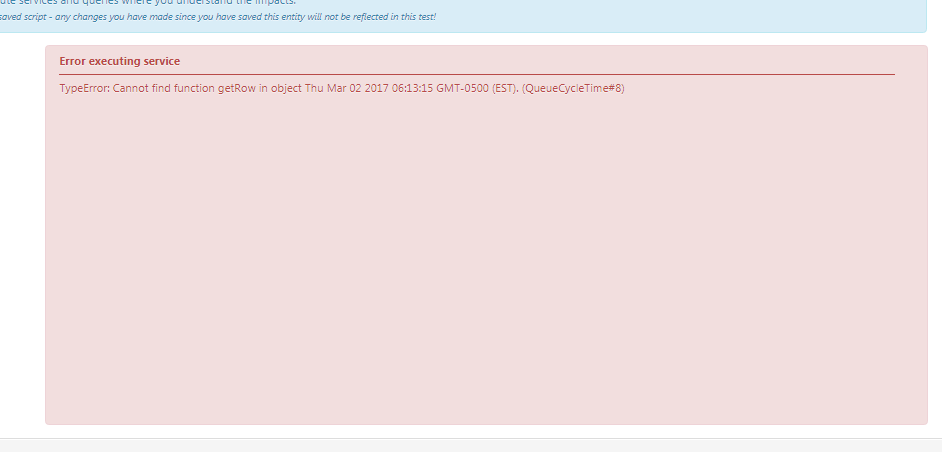

               I have a requirement such that I need to extract one particular cell value from the infotable data I have already tried this
var m= myInfotablename.Fieldname.getRow(rowIndex);
var result=m;
But as the element that I want to extract is of date time base type I have given output as datetime.
It's showing the above mentioned error where data is the name of my InfoTable and "Thu Mar 02 2017 06:13:15 GMT-0500(EST)" is the first row element that I wanted to assign to variable "m".
Please help on this

Try varm=myInfotablename.rows[RowNumber].Fieldname

Thanks a lot. It worked
