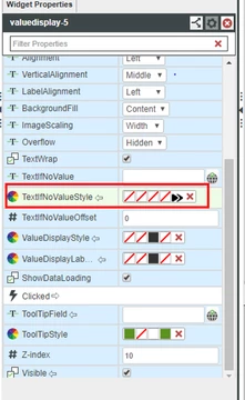

In previous version of thingworx, to assign media/image to value display we used 'TextIfNoValueStyle'. I'm not able to find this option in thingworx 8.5. Could any one help me to solve this.

In Thingworx 8.4, I'm able to set media entity for 'TextIfNoValueStyle' widget property (PFA PNG for reference). Now I'm not able to find this feature/property for Themeable value display widget in Thingworx 8.5. Please let me know if there is any other option to set media entity value to value display widget.
Thanks in advance.
