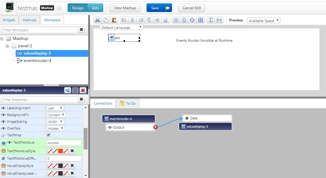

I am using the Event router widget. The output of Event router is bind to value display widget.
The output result is string. I want to display the text in red color. I have given style definitions to Value display widget. After binding the event router , its overriding my style definitions. I could not see the text in red color.
Could you please suggest how to apply the style definition to event router output text.

You have to set the ValueDisplayValue with a red style definition.
The red style you defined is for the text when there is no value.

Thank you for the solution.
