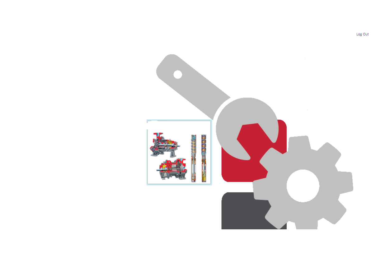

Hello ,
I have created a master page and there is a menu with associated mashup's.
To assign user i have created a organization with home mashup as the top mashup of the menu, and associated the user to the organization.
But when i login as the user i cannot see the master page with menus, with administrator i can see the page loaded.
What am i missing here..?
Sunay

Nov 23, 2017 1:59 PM UTC
Hello Mukul,
I have provided that but i am able to load only the mashup without any menu as i see with admin login.
with configured user login : I can only see the logout button.

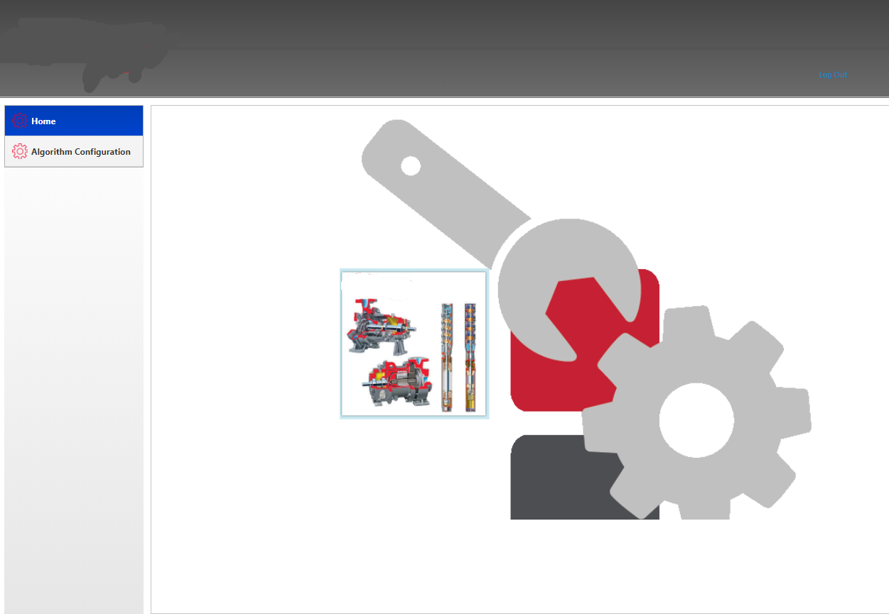

With admin login:
Also i have assigned the organization to master page, menus and all the mashup's associated to menus. But still i am not able to see the menu and the master page properly similar to admin login.
Is there anything still i need to do..?
Nov 24, 2017 8:04 AM UTC
Hi ,
You have given visibility to all the entities by adding organization in visibility .By this you are able to see only the mashup but the menu you are using should be using services for data .For this, run time permissions should also be there on that non admin user on all the associated services in Mashup .So that non admin user will be able to execute the service and display the desired data on mashup .
When you are logging in from admin user just observe all the associated services and give run time permission on those services for non admin user .
You can create a user group for that and add run time permission to that user group also just to avoid doing for each user specifically .
