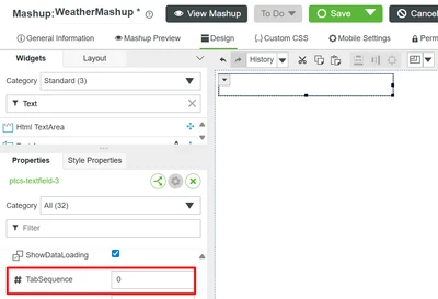

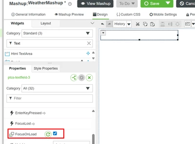

Hi @MA8731174,
Due to the nature of Tab Sequence (tabindex), you'll need to put all those with positive integers before the default zero ones to make it work as expected; otherwise, you'll have to correctly set a non-default Tab Sequence (>0) for every widget.
However, I don't recommend mixing Tab Sequences with positives (>0) and zeros (=0) on one page.
For your convenience, I suggest upgrading ThingWorx to 9.4 or later and using the FocusOnLoad feature.
https://support.ptc.com/help/thingworx/platform/r9/en/#page/ThingWorx/Help/Mashup_Builder/Widgets/ConfiguringAutoFocus.html

Hi @MA8731174 ,
Did you try the:
Also, if you want the user to move to another Text Field and enter the value in it, with the Tab key, try:

Jamal Ashraf
Sep 2, 2025 12:27 PM UTC
Thanks for your feedback but i cannot see this property FocusOnLoad in textField widget properties. My thingworx version is 9.3
pshashipreetham
Sep 2, 2025 12:55 PM UTC
Hey,
What about the Tab Sequence?
Shashi Preetham || +91 8099838801 || shashi@psptechhub.com
