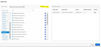

Add a property for the selected thing template:
  • Verify that the Data tab is selected in the upper-right panel and click the Add entity
  • Click the Select Entity drop-down list to expand it.
  • Select Thing Templates.
  • Click the Dynamic check box.
  • Click under the left-most scroll bar to scroll down to the Properties category.
  • Select the Properties category.
  • Click the Add
  • Click the Done button.

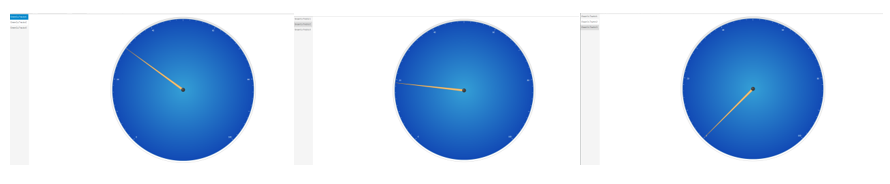

  • Drag a Gauge to the upper-middle Layout panel of the widgets panel.
  • Drag a property(temperature) from the Data panel to the Gauge.
  • Select Data.
  • Click the Save button.
  • Click the View Mashup button.
You can observe that the property value changes based on the selected inputs. This is one way of binding the properties to get the dynamic values.
