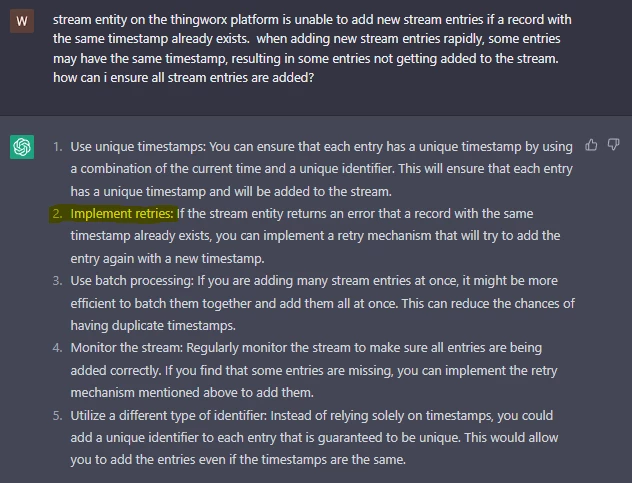

The use case was scrapped so I did not need the stream anymore.  According to @abhiramk , you can have the same timestamp in a stream if the source is different, but in my case, I had the same source so I was adding random milliseconds.  It might be possible to make the milliseconds less random if you have a property on the stream to act as a counter for milliseconds that resets to 0 after 999, but I haven't tried it so I don't know if it would work.  The threads might (probably) access and increment the property simultaneously.  As @nmilleson mentioned, maybe you could have a staging area for your data before adding them to a stream so you could ensure they are added.  Stage the data then change the timestamp one by one before adding.
Feb 10, 2023 7:21 PM UTC
Hi @TanmeyTWX
I asked ChatGPT.   Here's the response:
Thingworx - 2023-02-10 - ChatGPT response to duplicate stream entry issue3.PNG
I think a combination of #1 and #2/#4 could work.
