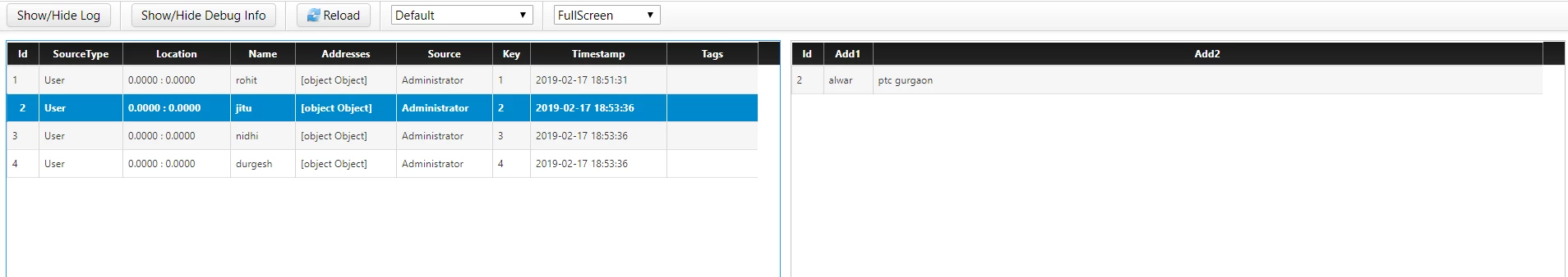

I have a two grids (Grid A and Grid B).
Grid A has multiple fields, one of them is a field with basetype infotable.
When a row from Grid A is selected, I want the infotable field of the selected row to display in Grid B.

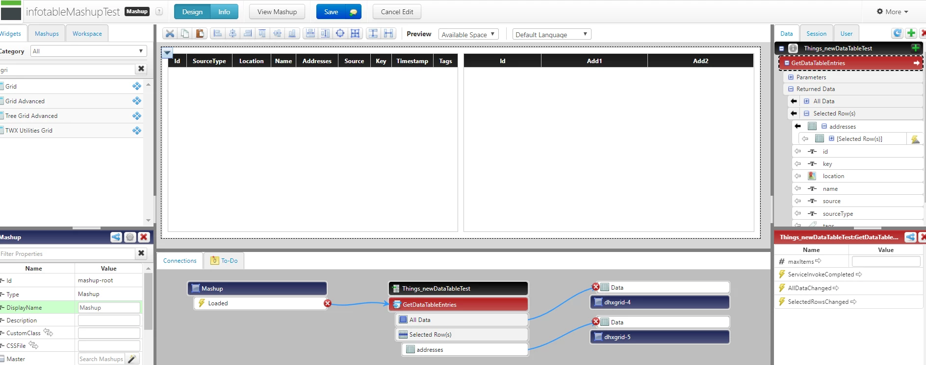

In the mashup,
1.  I have bound the infotable as an input data for the service for Grid B by selecting Selected Row under the service for Grid A in the service for Grid B.
2.  I have also set the Event Trigger by selecting SelectedRowsChanged under the service for Grid A in the service for Grid B.
3.  I have bound the output All Data from the service for Grid B to Grid B.
The nested infotable in Grid A is a Thing with properties which holds the infotable values.
I see the infotable field displayed as [object Object] in Grid A.
When a row is selected in Grid A, I see a row display in Grid B with blank fields even though the Thing has set values.
As previously mentioned, the data shape of the infotable in Grid A consists of strings, and an infotable.  Should the nested infotable be referenced as a Thing instead of an infotable?
How can I get this to work?

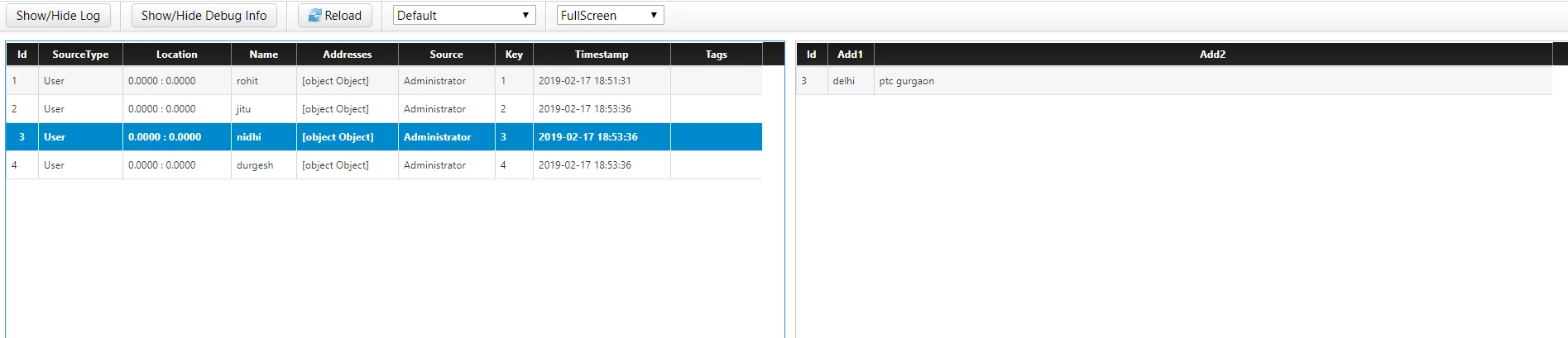

although in first grid for infotable column i see [object Object] but i select that particular row i am able to see data in second grid( the nested infotable)
there is no need to map the infotable input from service from first grid to service in second grid.
from the service going to grid A -- navigate to Selected Rows - expand that to find that infotable and directly drag that to Grid B

now i created a mashup- took a layout with 2 colums
placed one grid in left column and second grid in right column
from right side selected that datatable -- use getdatatableentries services to load the data to grid one(left side) on mashup load
further from selected row -- i see that addresses infotable field & draged it to second grid. no need to pass input to any services
screenshots showing the mappings and results are attached
