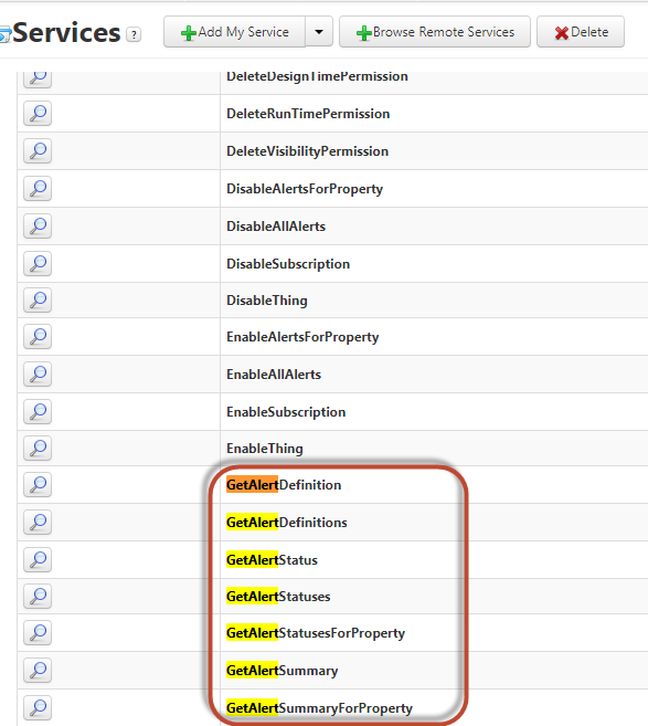

Hi David, have you already tested the alert service available with the template which you are using. With the above description it appears you can use GetAlertStatus or GetAlertStatuses

David, the services differ depending on what sort of Template you are using. The screenshot from my reply is from the RemoteThing Template. What sort of Template are you working with? And which version of ThingWorx?
