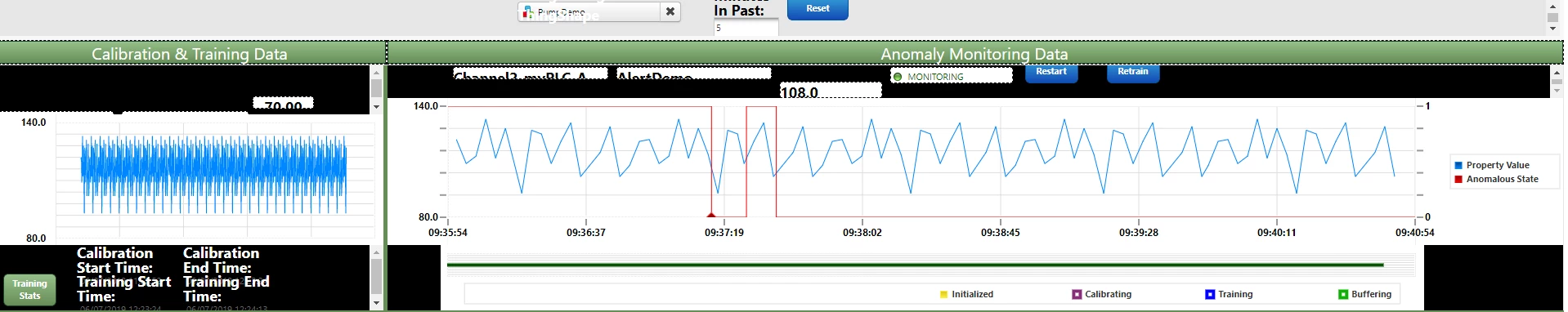

How to bind an anomaly alert with widget?
Hi all,
I want to bind my alert with widget, for example: When happen an anomaly alert show in my dashboard "Anomaly Detected"
I even created my alert and I am showing it in mashup below:
Regards.
zyuan1Answer
[Anomaly Monitoring status ] is an event that can be used to trigger Subscriptions, or if the property only has 1 alert and it's Anomaly Alert, the Alert event can also be used to trigger subscriptions, you can use these to execute your following steps.
zyuan15-Regular MemberAnswer
leinsfeld1-VisitorAuthor
Hi @zyuan1
Thank you for your answer!
I followed tha steps that you indicated and it is correct.
Regards.
