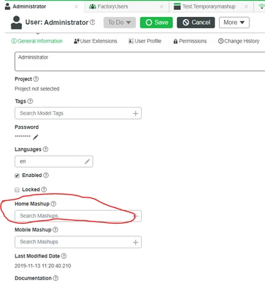

Usually you create one main mashup from which you can navigate to different parts.  Per user you can specify that Thingworx opens on that mashup. This gives the impression similar to when you open manufacturing apps.
