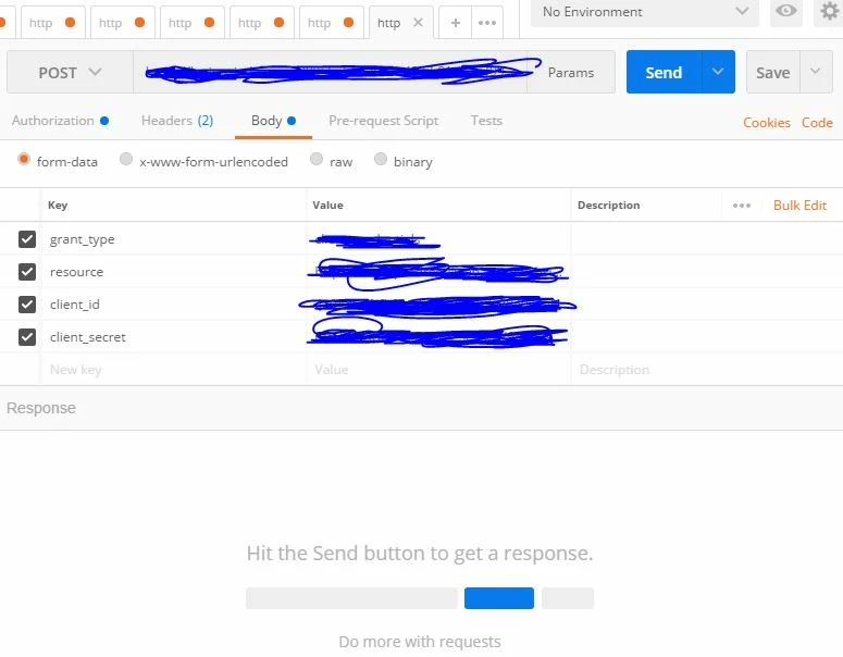

How to call an external rest api which accepts header and body as input.
I would like to achieve the same call through thingworx what i am able to do it through postman(attachment for reference) .
I tried using snippets but was not successful.
I have to pass 2 header information and 4 body information with the url to get the JSON as a reply. How to send it through thingworx ??

Hello PaiChung,
Below is the snippet i have used. I have passed the body in content.
//JSON object to send
var HeaderJson = {
"Content-Type" : "application/json",
"Accept" : "application/json"
var BodyJson = {
"grant_type" : "",
"resource" : "",
"client_id" : "",
"client_secret" : ""
var params = {
headers: HeaderJson /* JSON */,
url: "" /* STRING */,
content: BodyJson /* JSON */
// result: JSON
var jsonresult = Resources["ContentLoaderFunctions"].PostJSON(params);

Hi @sbt,
Please try the following script :
var HeaderJson = {
"Content-Type" : "application/x-www-form-urlencoded",
var content = "grant_type=client_credentials&resource=http://some_url&client_id=xxxxxxxxxxxxxx&client_secret=xxxxxxxxxxxxxx'"
var params = {
url: "http://{some_url}" /* STRING */,
content: content
// result: JSON
var jsonresult = Resources["ContentLoaderFunctions"].PostText(params);
Himanshu
