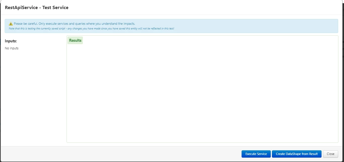

How to call RestApi
I am using below code for creating service to call RestAPI in thingworx ,
while executing service it is not giving any error but at the same time it is not giving output also,
please suggest what am i missing
below is the code:

var result = infoTable;

    Hi @Harsha11.
    Apologies for the delay in responding to your post.
    Have you defined the basetype for the output?  If you have already resolved this issue, please post your solution here for the benefit of others with similar issues.
